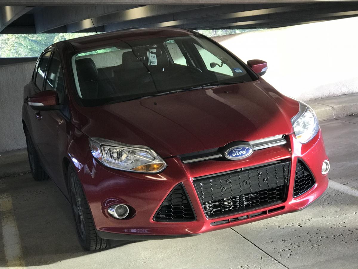

Anthony Posted September 11, 2017 Share Posted September 11, 2017 (edited) I just received my new (Ebay bought) Zetec Style Grille. I was cheap, so I figured what do I have to lose? I never liked the look of the solid plastic ribbed grille on the 2012 - 2014 Foci, but thought the opening could look better. Overseas, they offered the Focus with a Zetec package which gave it a honeycomb style grille. This replacement grille is basically a copy of that. Here's an example (not my car): I'll be installing this in the coming week and try to document it. Here's what I got: Edited September 11, 2017 by Anthony 2 Quote Link to comment Share on other sites More sharing options...

Anthony Posted September 17, 2017 Author Share Posted September 17, 2017 (edited) Heres one Edited September 18, 2017 by Anthony 2 Quote Link to comment Share on other sites More sharing options...
sullynd Posted September 17, 2017 Share Posted September 17, 2017 Sharp! I always thought that design theme was abandoned too early. It was just the Focus and Kuga/Escape right? Quote Link to comment Share on other sites More sharing options...
tbone Posted September 18, 2017 Share Posted September 18, 2017 I think that looks a lot nicer than stock. Nice work. Quote Link to comment Share on other sites More sharing options...
fuzzymoomoo Posted September 18, 2017 Share Posted September 18, 2017 Looks more like the grill they had on the titanium. I always liked it better until they messed it all up for MY2015 Quote Link to comment Share on other sites More sharing options...
Anthony Posted September 22, 2017 Author Share Posted September 22, 2017 (edited) Heres one last I took in the sun today. Definitely like it better than the stock grille. Now I just gotta figure out how to mount my license plate since this has mounts for Euro plates. Edited September 24, 2017 by Anthony 2 Quote Link to comment Share on other sites More sharing options...
